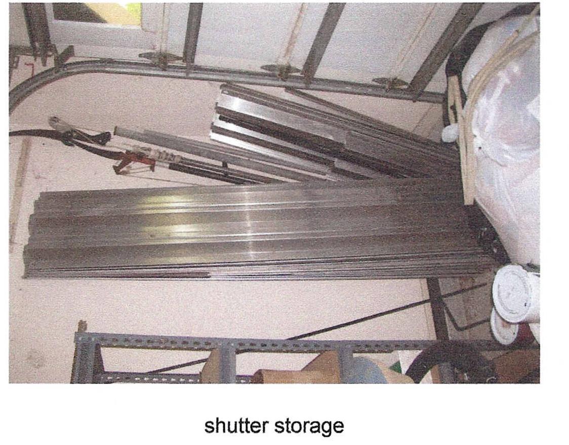

A local contractors turned in a wind mit yesterday, the facts are as follows:
All windows (except garage door glazing) had storm protection in the form of panels.
The garage door was as per photos.
House was built in 1986
The contractor marked “E” All Glazed Exterior Openings are fully protected at a minimum with impact resistant coverings and/or impact resistant window units that meet the requirements of one of the standards listed in answer “A” of this question (large missile - 9 lb)
Is this correct?
If not, what should have been marked?
I agree with J. We need to have one set of standards taught to the inspector. Just because you have a license doesn’t mean that you know how too perform a wind mit.
Even after I explained to my contractor friend that the garage door needs to be included as an opening, especially with glazing — and showed him on the form under “9. Opening Protection” where it explicitly refers to garage doors — He still didn’t get it. He doesn’t own a Zircon and does not verify or photo any product approval. He performs around 10 -15 wind mits a week. I can’t imagine how a report like this would be accepted when the attached pictures clearly indicate that the form has been incorrectly filled out. Guess i’ll see this one on the re-inspect.

I agree that he will eventially be on the “do not use” or “do not accept” list, which I hope happens sooner than later. My whole purpose of the exercise is to help educate those willing to change their ways by reading the responses of more experienced inspectors. Since there is no book of correct answers given to us by the OIR, we need to essentially derive at our own best guess using reasoning and logic. Through the process of ellimination, we can at least, as a minimum, agree on what selections cannot be correct.
I believe that in the near future, Citizens for one, will possibly not accept WM inspections from individuals that they determine, through review of reinspections, have repeatably submitted erroneous reports. It only makes sense to illiminate those that cost them $ by granting unsubstantiated credits
