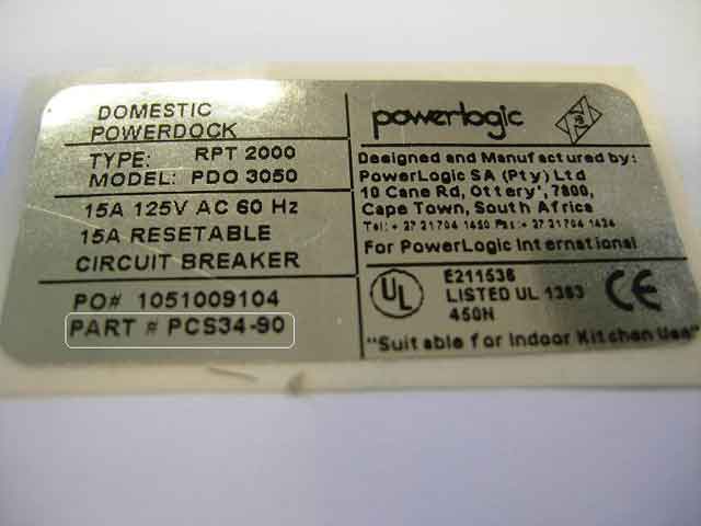

Are there any updates to this? I found this product through the gardenweb forums and followed up with Mockett.com on the UL listing which does seem valid.
Also what does IP54 mean?
Absolutely not, but not for the reason you might think. The item pictured is not a receptacle, but rather a UL listed electrical accessory known as a “current tap” (not a relocatable power tap), listed in the UL White Book under *“Current Taps and Adaptors (EMDV)”. *The actual receptacle itself for this current tap (the receptacle that is NEC required) is installed under the counter top, in the back of the cabinet, and this current tap plugs into it. This is no different than installing the required receptacle in another room, and running a long extension cord to lay on the countertop and calling it “the required countertop receptacle”. This is a violation of the basic rule that counter spaces with a wall or back splash must have the receptacle mounted above the counter top (up to 20" above). There are two exceptions to this, neither of which apply to the installation referenced. As an optional receptacle, they’d be fine. As one of the NEC required receptacles, they are a violation, because the actual receptacle is under the counter. When someone makes a hardwired version, then they’d be compliant for kitchen counters with wall space. None such on the market yet, that I am aware of.
It’s the DIN (Europe) standard that is basically equivalent to what we’d call “weatherproof” (NEMA 3R). IP stands for “Ingress Protection”, and the digits that follow enumerate what type of ingress protection, very similar to our NEMA enclosure ratings. IP54 is good for dust and splashing water.
IP rated enclosures only address ingress of solid objects and liquids. NEMA goes much further.
I looked up the UL rating for this item. The file number is E211536. It’s listed as a relocatable Power tap. Does this mean it can be used in lieu of the backsplash/wall receptacle?
Also what constitutes a wall? We have a bar over our island. It’s held up by a 1" wood panel on the end of the island. The panel is 6" higher than the counter. Would that be considered a wall?
