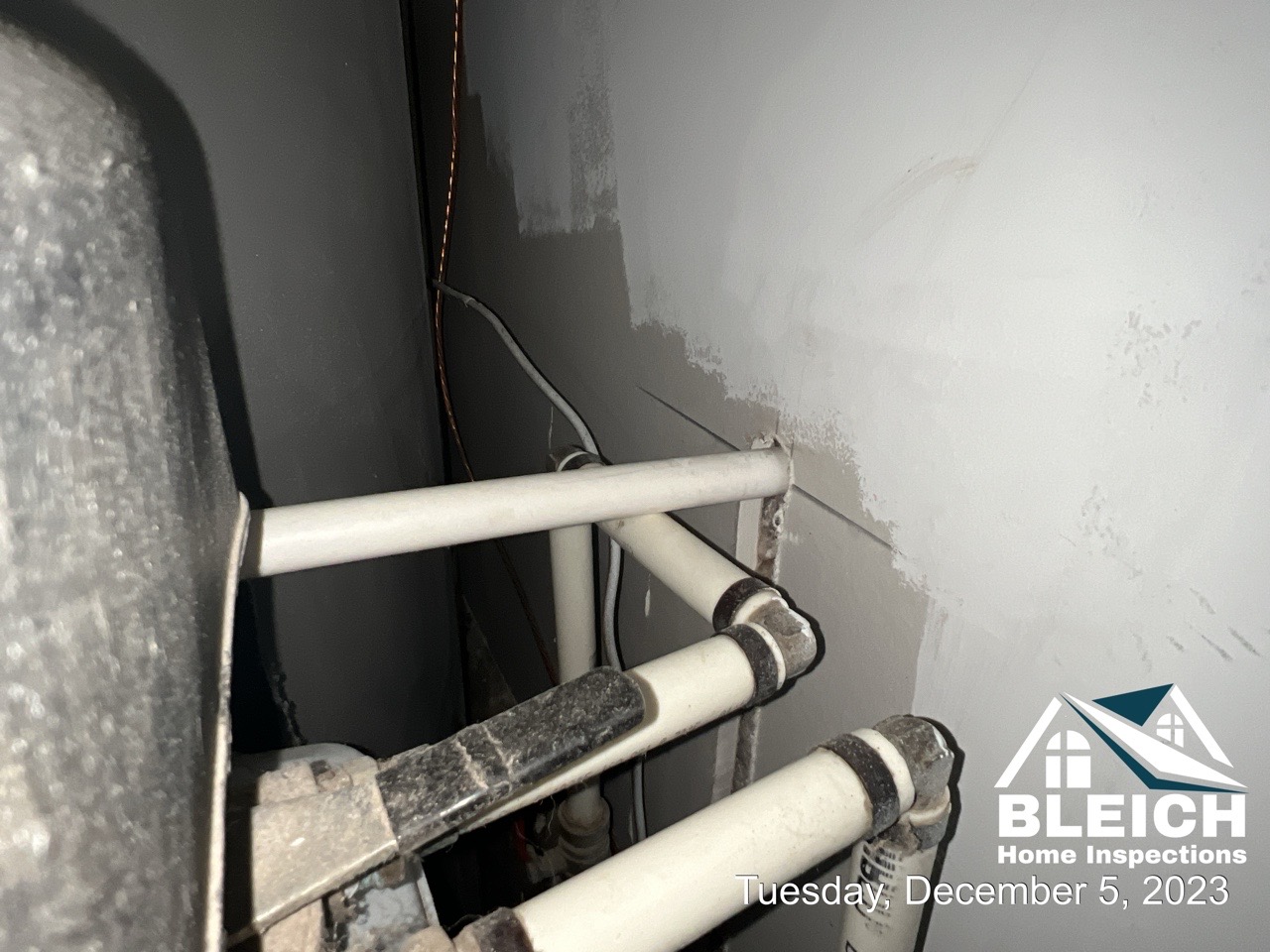

The HE furnace, evap and humidifier drain condensate pump discharged into the side of the TPR drain, tee’d into the water softener discharge and went into the wall possibly to the bathroom drainpipe.
Lol. Not to mention, you don’t want PVC involved with the TPRV discharge.
What did you say about it in your report?
“Unit was tested and operating as intended at the time of inspection. Recommend thorough sanitation prior to use.” :rofl:
