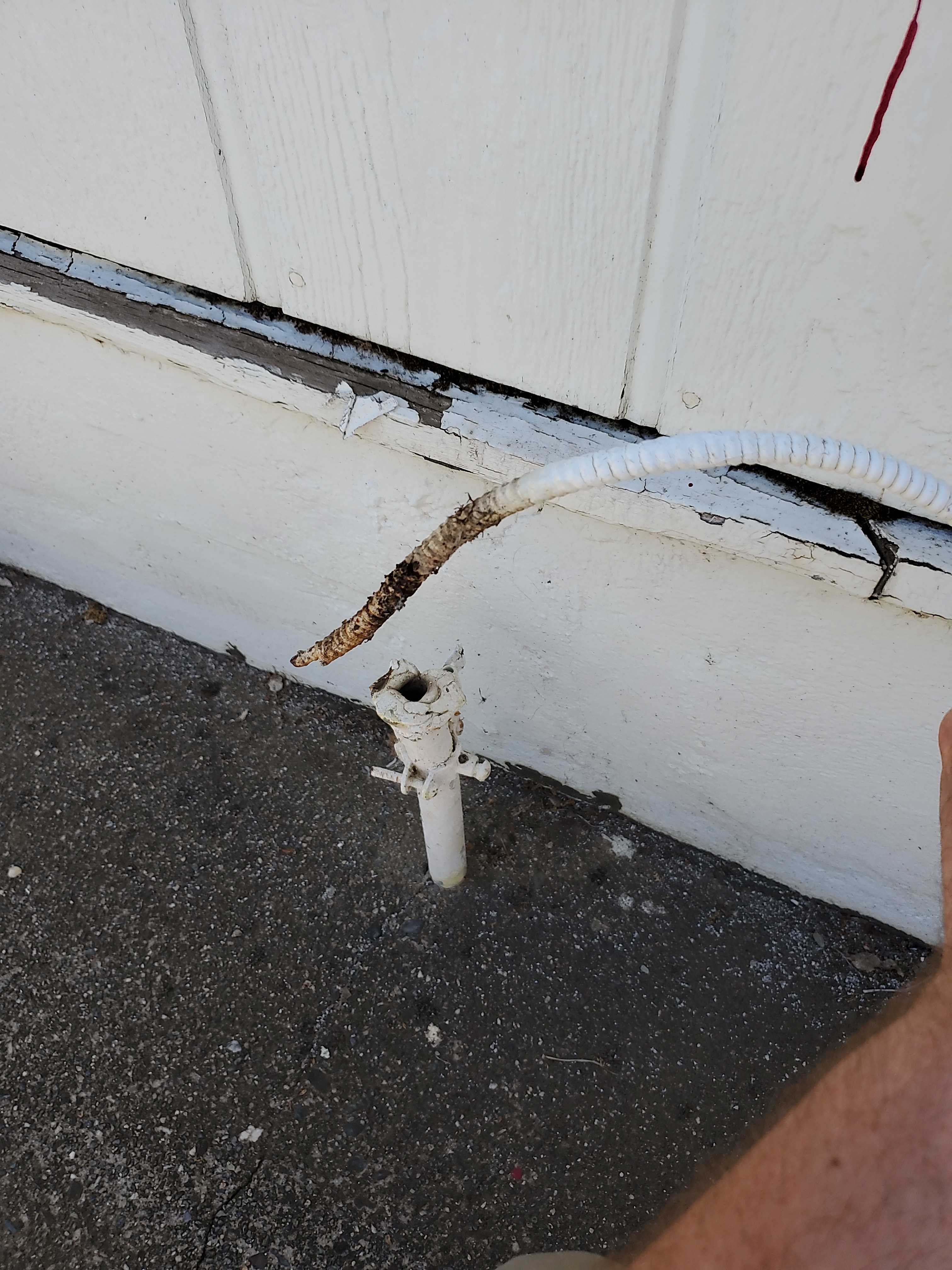

Don’t know if the scupper dispersing roof water from the garage flat roof to into a downspout for the residence sloped roof would be considered a defect, Daniel. It would not make a mention in my report other than a brief description.
Thanks for sharing. We all learn by contributing to the MB.
I didn’t call it a defect either, only because there was a downspout at the other end. But I did mention it in my report… It would only take 2 leaves to clog that 1" pipe… And the gutter was completely full of debris.
Ok, you currently have the award for “funniest”!
