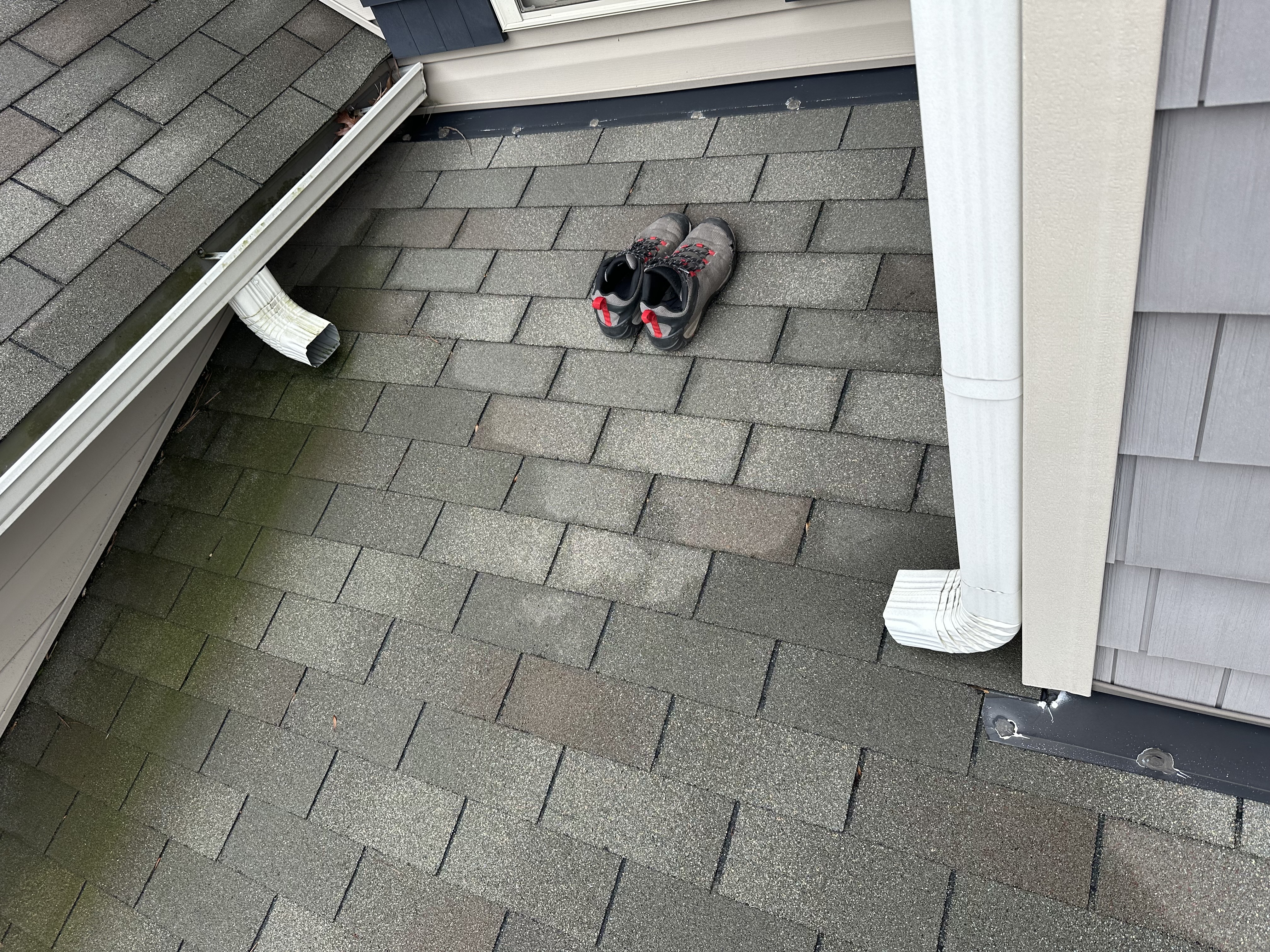

whats with the shoes?
My guess is that they are outside of a teenager’s bedroom so they can sneak out at night.
lol I forgot to take those out of the picture. Those are my roof walking shoes. My normal shoes have no laces and I can slip out of them easily
