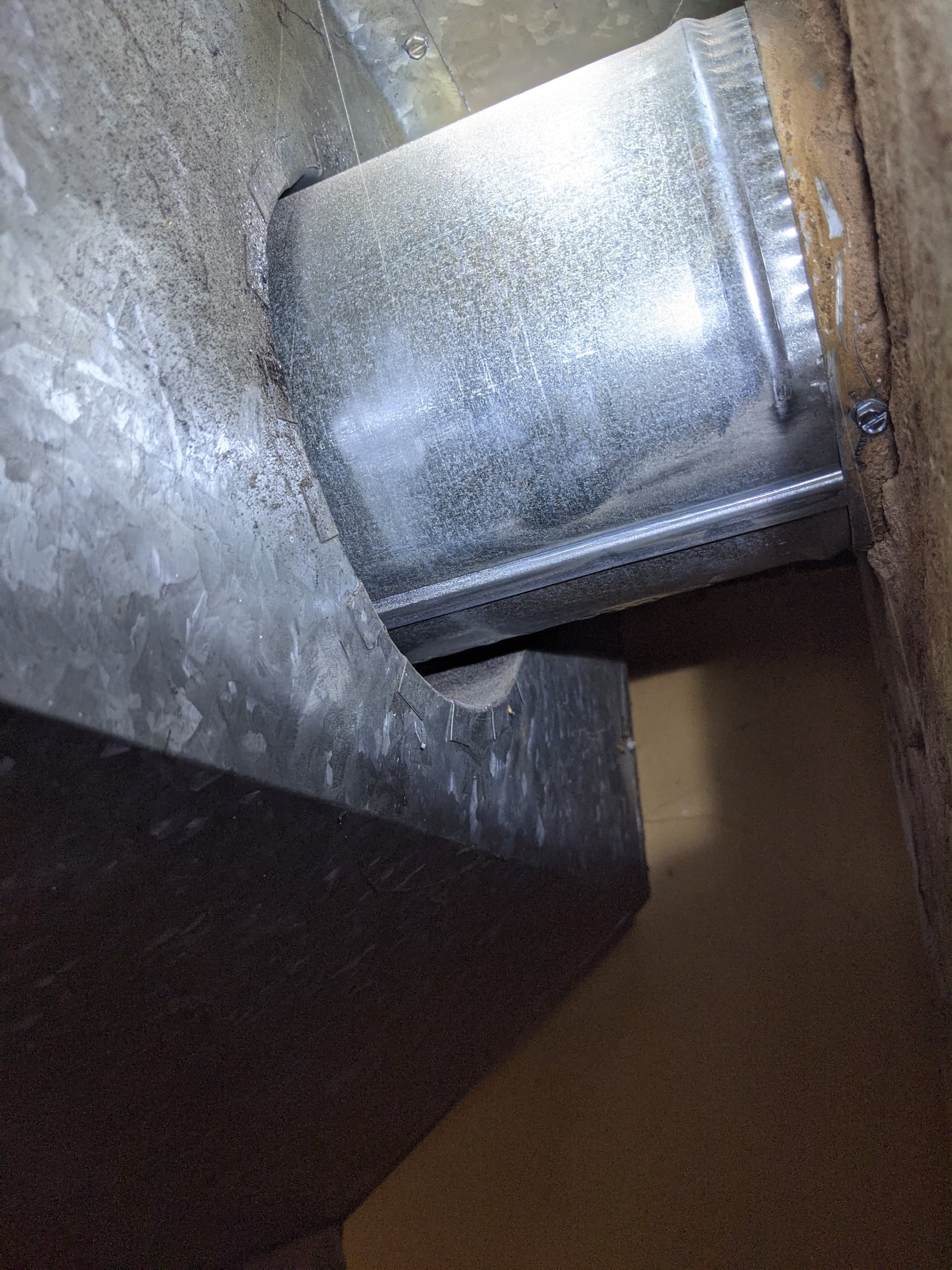

When the return air is in the way of the exhaust just cut a hole all the way through the air intake and get creative with sheet metal. .

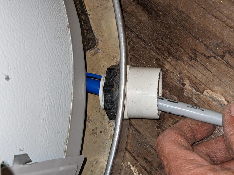

It hardly counts, since I see it so often. But what’s up with putting a drain pan under a water heater, then letting the water drain on to the floor?

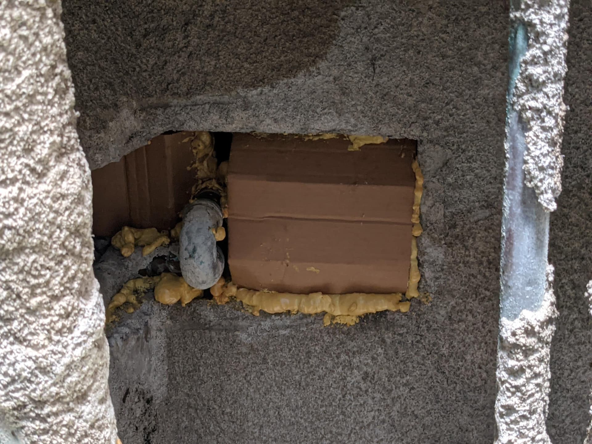

Ceiling of a commercial building parking garage:
The plumber apparently hacked out the asbestos fireproofing, then used cardboard and regular (e.g. burns like gasoline) spray foam as a filler.
