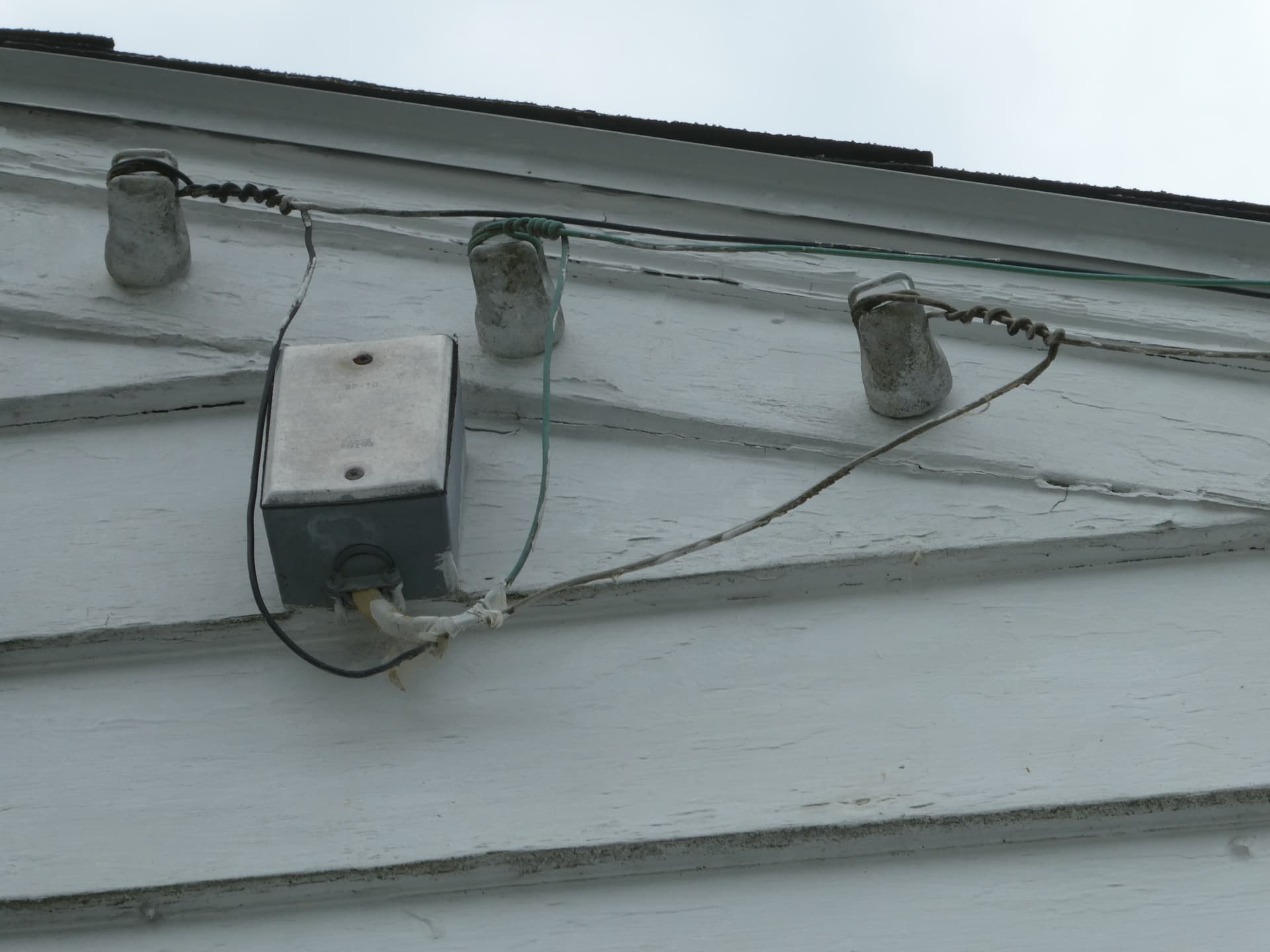

Overhead conductors for the garage.
They could have at least used a darker color of bathroom caulk.
That would indeed, be a clothesline.
How on earth was a smart meter installed into that mess?
And could I get anybody to care? Well I suppose I could have called the POCO or 911. Short of that getting yawns so far, though that line crosses two public sidewalks and a street.
Hey, at least it’s a nylon reinforced clothesline holding it up, rather than pure cotton.
