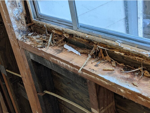

Bottom line is, anyone drilling holes and driving nails through and window sill for any reason has got to be a total idiot, if he expects to not have any problems down the line.
Nothing is hidden. That’s a photo from same set of four windows.
It’s a rare case where I got to have effective X-Ray vision, seeing the windows intact, and then at two stages as the walls were torn apart to chase a musty smell. I’ll get a fourth visit as I’ve been called back to inspect the repair work prior to finish drywall.
This was not pre-planned. I did not take documentary time lapse photos from the same angle of each window to try and satisfy the members of this forum. The photos were taken to illustrate the issue to the client.
I indeed filled the window tracks with dye filled water to demonstrate to the contractor how to clean the weep holes on the other windows in the complex (the same crappy design). I have zero concern over water testing something like this: it’s the “normal operating condition” of these tracks to get filled with water, so why not do it on a dry day and figure out if they’re draining properly? Doing Damage During an Inspection: It's Your Job - InterNACHI®

I tried to make mine entertaining. But by providing just one closeup of the area of concern, I may have been too leading. When I originally approached the situation I obviously had both more and less context than someone seeing the pictures later. More context: in that I could examine what I wanted to. Less context: in that I did not yet know there was a notable defect to be discovered and thought I was just looking at standard crappy windows similar to those in any number of other buildings and hardly worth a second look.
That’s the same project, same punctured window track.
At the time of my first visit, the only visible problem was the prior stucco patch on the outside of that particular window. Note the PT lumber in the photo.
At the time I vaguely remember thinking the cheap floating hardwood floor had a soft spot but did not pursue the matter or write it up. It turns out to have been a rotted subfloor.

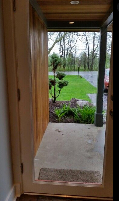

@bcawhern1 was this a required egress door?
@bcawhern1 opinion is fine, that’s what we get paid for :slight_smile:

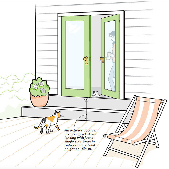

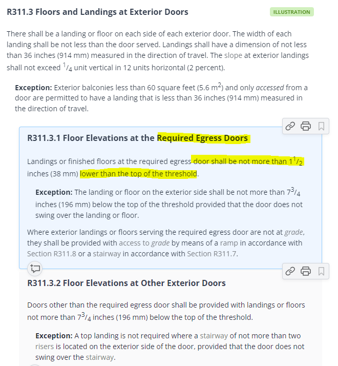

That said, at the risk of turning this in a code form, rather than a happy WWW picture thread… there was a recent code change that strikes pretty close to your situation, made in the IRC in 2003, and then adopted by the states some over the next years.
2003 IRC, in R311.3.2:
While the egress door still has to follow the strict requirement of having no more than a one-step height difference (73/4 in. max) between exterior landing and threshold, an exception was added for all other exterior doors, which are now allowed up to two steps between the landing and the threshold.
Each side of every exterior door (egress and non-egress) is required to have a landing, providing a stable place to stand while one’s attention is focused on operating the door. This landing must be at least the width of the door and 36 in. deep “in the direction of travel” (with an exception for Juliet balconies accessed only by door), and the landing can be sloped for drainage or construction tolerance up to 1/4 in. per ft.
A door can swing out over a single step.
Screen doors are excepted.
I agree your situation is a hazard. If it’s bright outside, a person may hardly be able to see properly when stepping inside, and step may be out of place.
2018 IRC Got get up to speed.
I did not inspect this 1930 home to code. However, I did inspect it for safety.
Agreed!
That door DOES NOT swing out over a step!!
