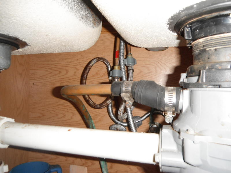

Here’s one from today’s inspection. It is a copper water line used as a drain line for the dishwasher.
Nothing wrong with that, just a lot more expensive than rubber. Does need a high loop though.

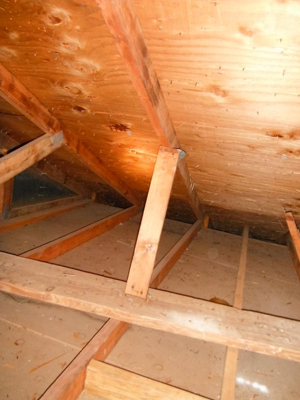

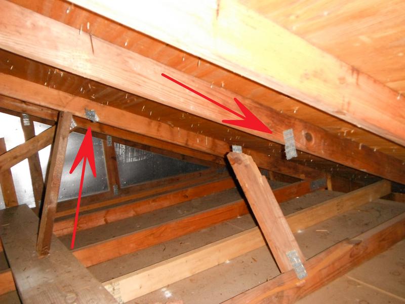

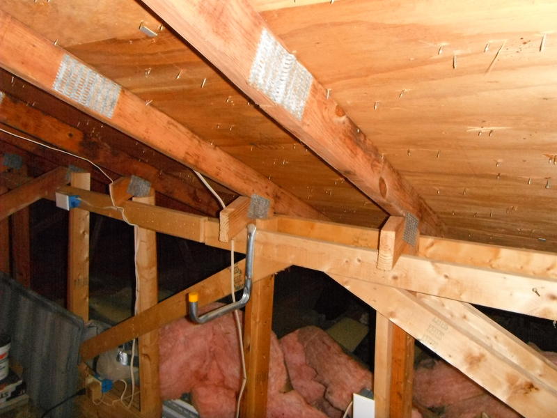

The darn trusses didn’t leave any room for storage in the attic. The owner wasn’t an engineer, but he did stay at a Holiday Inn Express once, so he made room.
Thanks big time love all these Great shots .
Nothing a little sawz-all won’t fix, right Troy? :mrgreen: :shock: :roll:

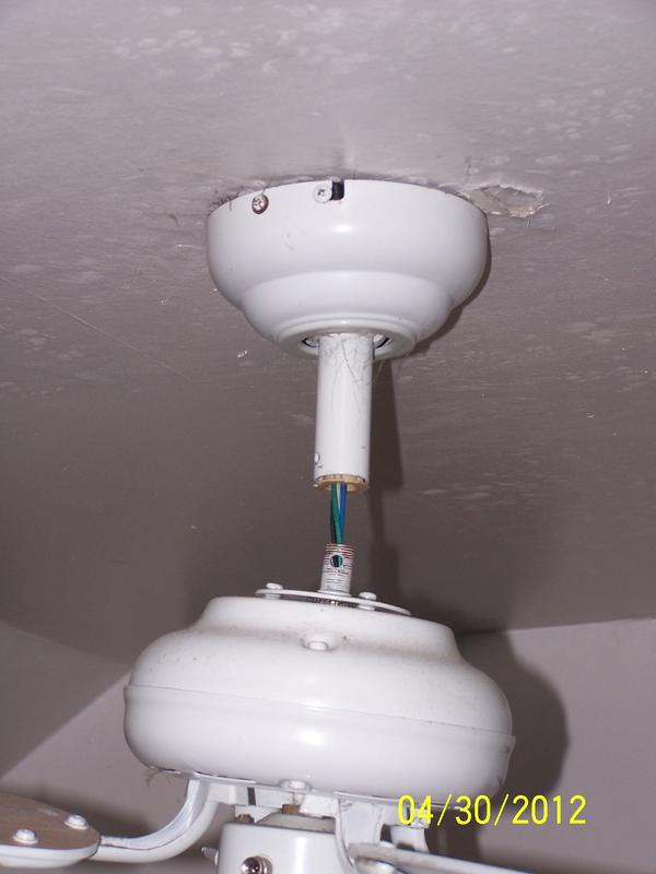

A few days ago I was standing under this fan. The wobble was crazy :shock:
The sad part is that the tennant actually uses this fan.
