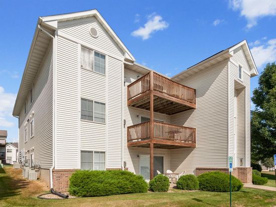

I am doing my first shared roof condo. How do you go about writing up roof and exterior in a condo if it is not going to be inspected? The pic is the condo I am inspecting and the location of the unit is the 3rd floor.

I usually look over the exterior and roof because there might be something that could affect the interior of the clients unit. The HOA might not be aware of it so if there’s a problem, I’ll put in the report.
If there are issues with, let’s say, the roof, then in my Roof Summary, I’ll put this:
“The Homeowners Association (HOA) is responsible for the roof system. Any mention of roof system issues in the report are complementary only.”
“The Homeowners Association (HOA) is responsible for the roof system."

I always inspect the exterior and roof when possible. If the roof is in poor condition and in need of repair or replacement, then I report this to the buyer. I don’t want the buyer to be surprised by a Special Assessment, by the HOA for a new roof after they move in. Same goes for other big ticket items like parking lot pavement or painting.
As a home inspector, our job is to report on the condition of the property. Whether an item is the owner’s or the HOA’s responsibility, the condo owner will have to either directly or indirectly pay for it.

I would not put that in my reports as (at least in my state and local), HOAs will very when it comes to responsibility of the roof and exterior. Some will assess a special fee when the complex is going to replace the roofs or make repairs to a roof that is common to a particular building, they may asses those effected. This is very much more likely for those that have composite shingles rather than tile. It is best to inform your client to read the HOA documents. I have found where some will also asses a fee when the common streets and parking areas are in need of refinishing or repair.
I inspect the roof or drainage area as far that it may effect (above) the unit I’m inspecting, even if the client’s unit is below another dwelling. I report it the same and if a defect, report it and then maybe inform them to check their HOA documents for responsibility.

I charge the same for a condo as an SFM. And I inspect and report on all accessible exterior above, below, and around the client’s condo unit. Including parking lot, sidewalks, stairways, lighting, decking, etc.
IMO - anything less is lazy and a disservice to my client. If the client is paying a $3K a year maintenance fee, they should be informed of neglected or delayed maintenance.

Okay. Now - after all that - hows about just read that little snippet you added from my original response. SEE Keywords: “accessible exterior”.
And in this case…when viewing the photo in Tim’s original inquiry - what kind of hurry would an inspector have to be in to not check the exterior of that building?
