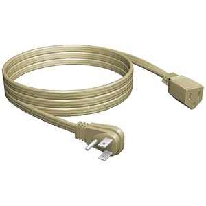

No matter how you look at it, you can only plug one of these male plugs in on a duplex receptacle.
http://ecx.images-amazon.com/images/I/41hzXbgmLNL.SL500_AA300.jpg
:slight_smile:
Safely!!!:slight_smile:
And conveniently. :slight_smile:
And since when did convenience ever make a difference to the man with an agenda?:wink:
Get a splitter. :mrgreen:
