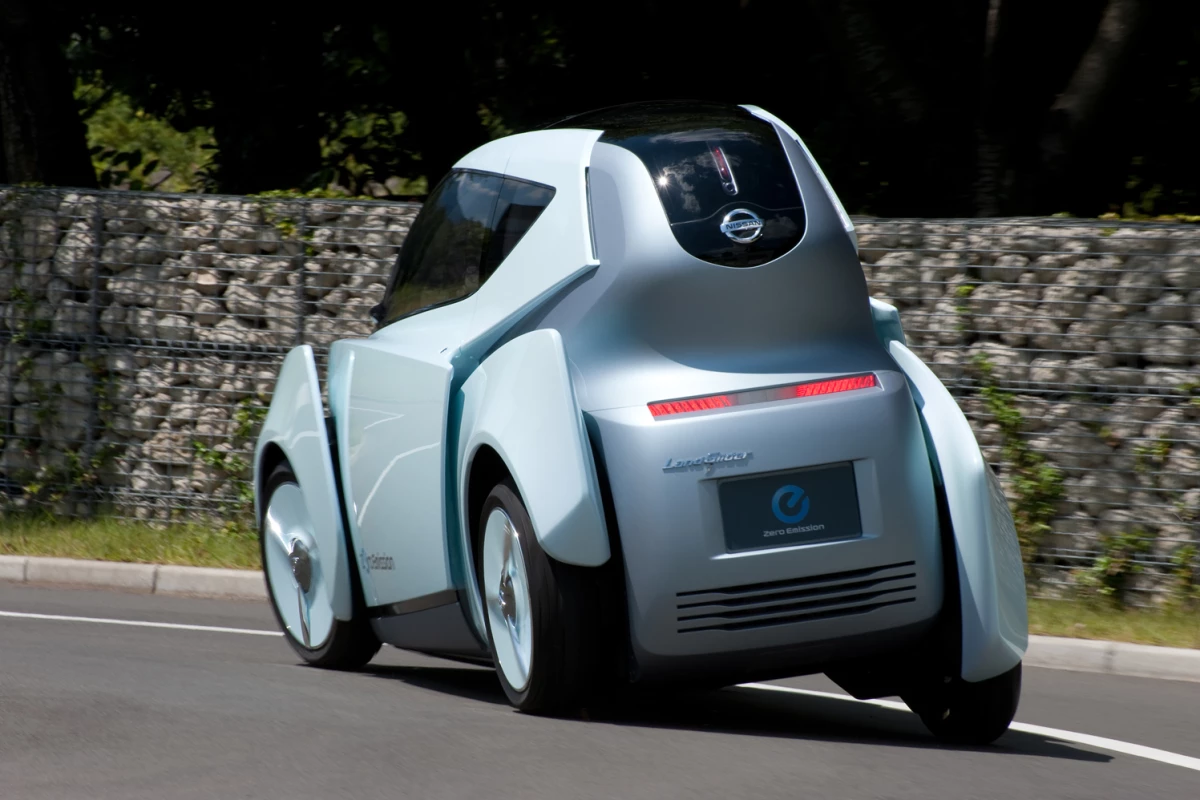

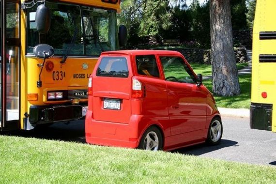

Adding to @jjonas storing anything with a battery, including riding lawnmowers and the enclosed commuter car equivalent of a riding lawnmower:

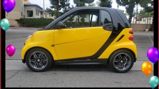

Or the sporty version:
