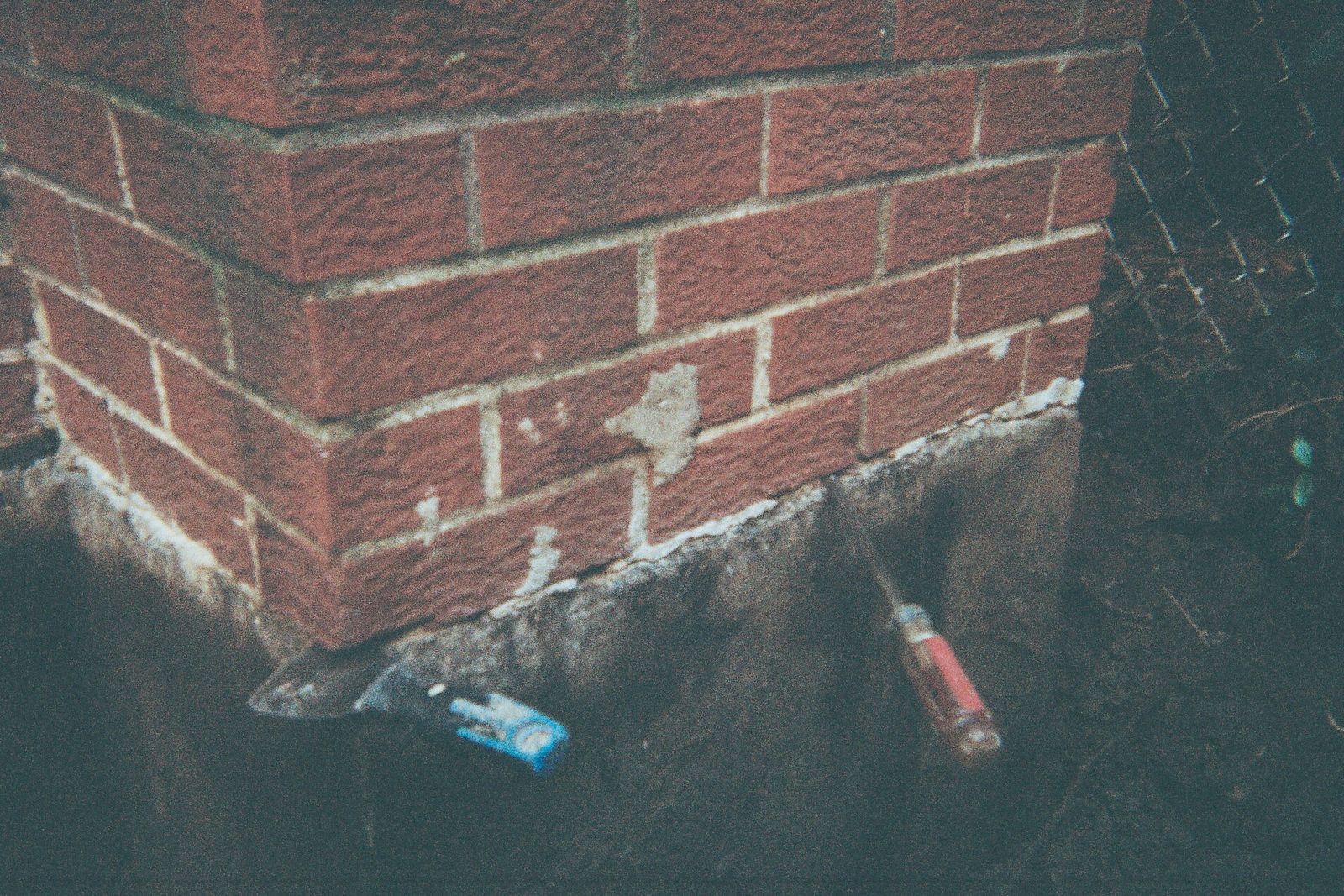

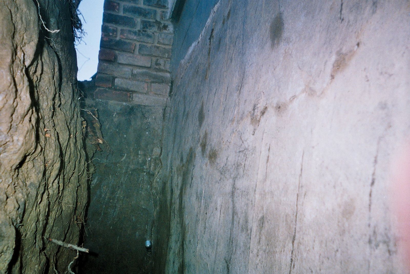

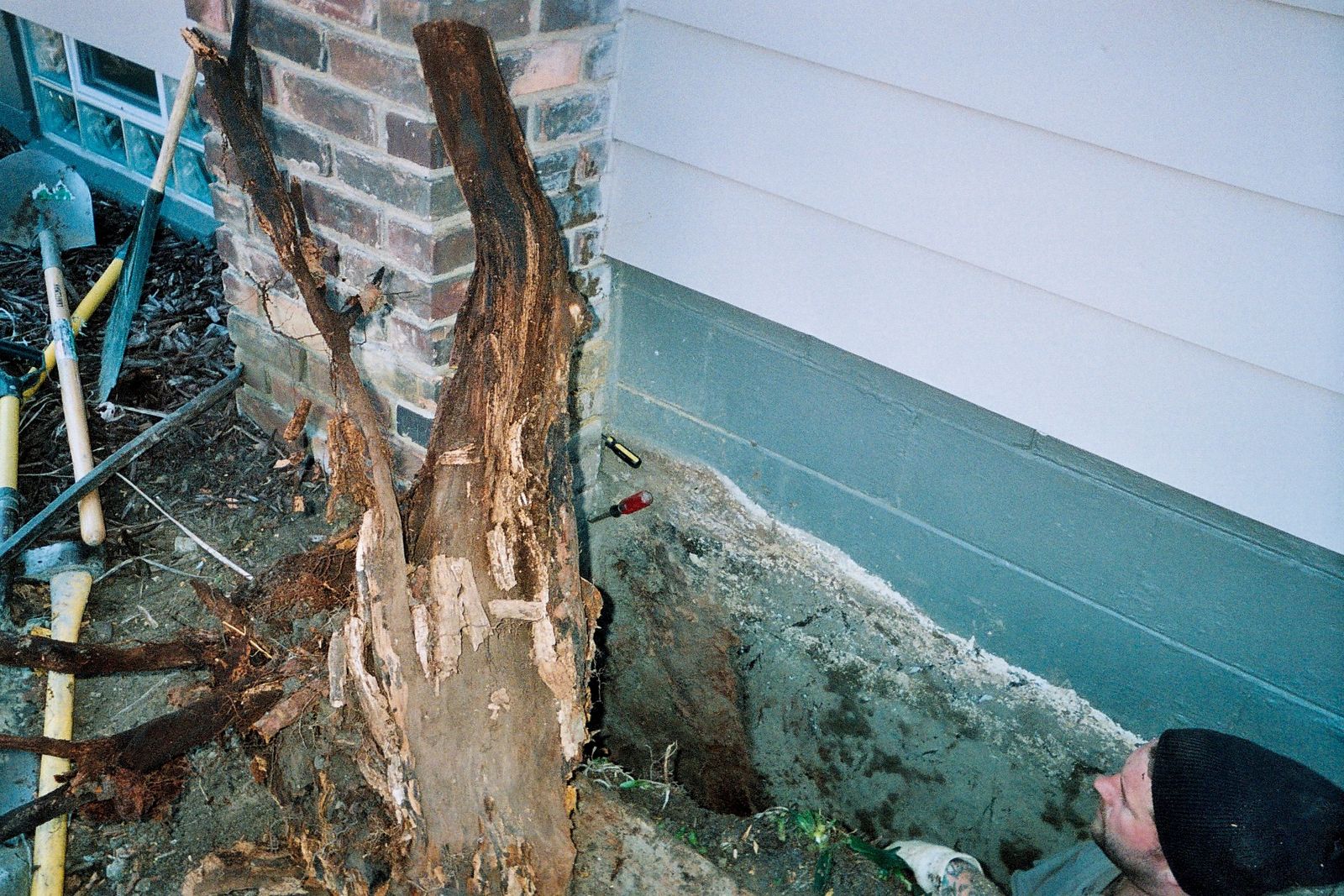

My estimate $2,300 to break out 3 walk slabs that are along chimney area-house and then hand dig 7’ deep and waterproof the exterior of chimney walls, backfill with all gravel n haul all soil away. Just to haul soil costs $450 small job
Photos below, example of what will be open on exterior chimney wall (s) below his concrete walk
what needs to be done if you want to STOP the water from where it’s entering and save around $12,000
