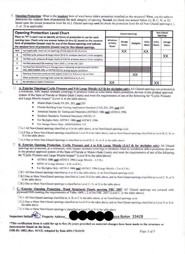

I am a new inspector and I took the course for wind mitigation inspections. The one thing that was not clean was the difference between glazed vs unglazed openings. Can someone please explain the difference to me.

Glazed = Glass.
Windows, sliders, glass blocks are glazed.
A solid front and/or side entry door, overhead garage door (solid) are non-glazed.
