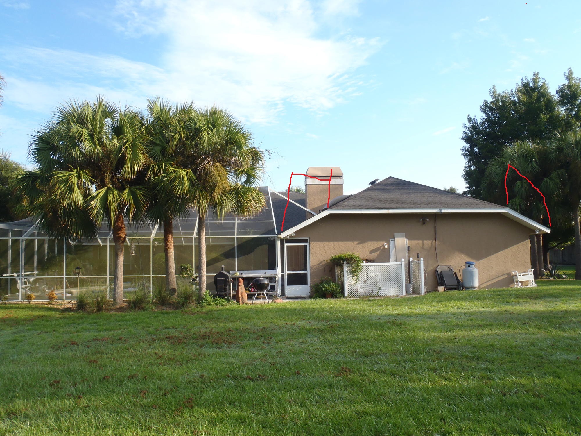

Do half hip roofs qualify as a hip roof on a wind mit inspection? Thanks in advance.
Jerkin-head Roof
These would be measured as gables.
Thanks
Except for the overhangs…
