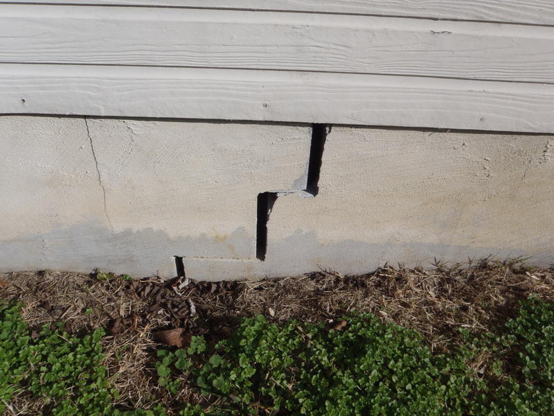

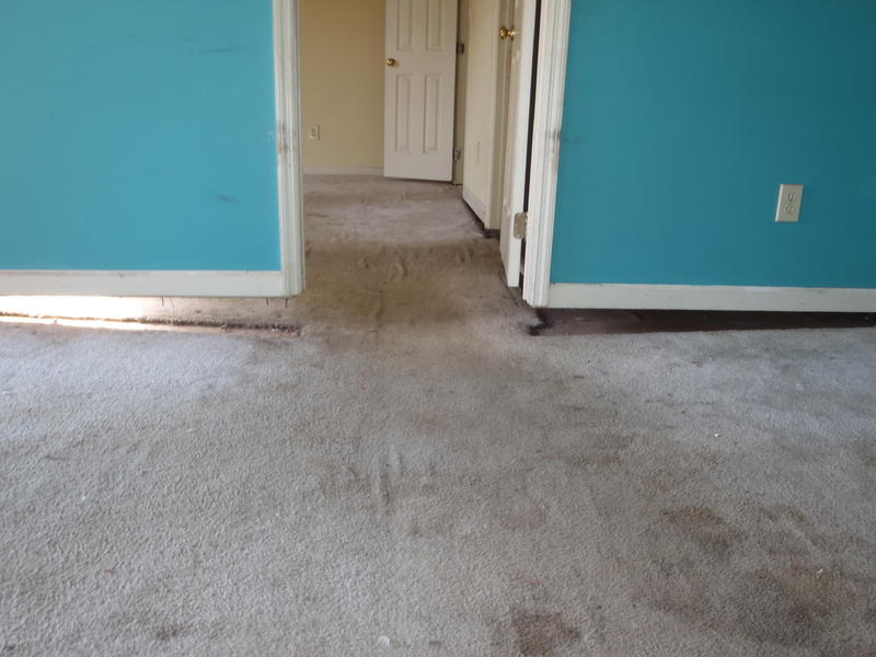

Is a structural engineer neded for this??
Two guys that were contracted to fix this house up for the bank called me and wanted me to come look at this home. I asked who brought the gas…:stuck_out_tongue:
I figured a sinkhole. The other homes around also had visible cracks in the foundation. This by far was the worst home I had ever seen. :shock:
I think a bulldozer is needed more than an engineer

Structural engineer, foundation contractor, or demolition team. :wink:
proper slope for drainage 6" over 10’ Oh wait that’s for outside the house! Maybe that was the lot where the buried all the tree stumps.
PE not needed for review as the deficiency is obvious.
Recommend RA or PE to specify repair.

A structural engineer would be my second call. I would start by recommending a geotechnical engineering firm to do soil borings first. That is way beyond normal settlement.
Exactly.
There is an area here susceptible to sinkholes as the soil conditions are predominant for Limestone.

Normally a soils test would be first for most houses but this sounds like a vacant bank owned house that would be worth very little even without this major problem.
I would recommend an appraiser and contractor get together first to see if its even worth investigating.
I bet the bank never spends the money on any engineers.
They will just sell it to someone for a little over the value of the lot which is probably too much.
Thats the sad part. It really should be condemned and torn down. THe whole lot was in a hole. I can only hope when they do fix it I may be fortunate enough to get to inspect it again. I think its sad to think the bank could try to push this onto someone else “as is”.

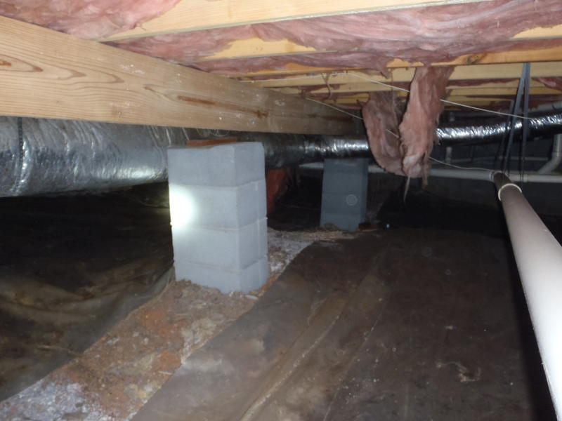

Post foundation ( half rotten posts)
