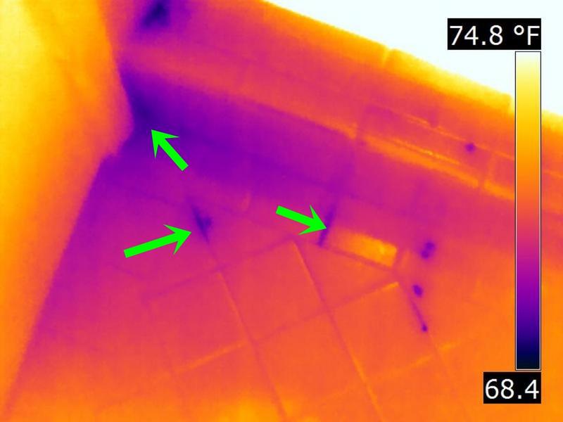

Ponca City Oklahoma home inspector finds more leaking shower pans with thermal imaging camera anywhere in the State of Oklahoma than Oklahoma Certified Master Inspectors find:D
You sure that’s not splash from you running the shower?
You can tell it’s a been a long term problem by the water that’s been wicking up through the door trim.
Positive, I don’t let a drop fall on the floor not one single drop;-)
Oh, yes. I didn’t look at that photo earlier.
Gotta lift that lid first…
Sorry, CMI the home had been vacant for weeks nice try but no cigar:p

You have to think outside the standard SOP I fill the stall with water no more than 2 inches and let it set for at least 30 minutes sometimes longer if I get busy with something else. If the stall is old looking I do a before and after scan of all the walls that are exposed. Sometimes in Okla I get lucky and have 4 walls surrounding the shower like a walk in closet surrounding the stall, if not I scan what is available sometimes its just the front opening below the stall. If I find a suspicious area I back my IR findings with a moisture meter I take a digital of the moisture meter. Thermal images and digital all go in the report. Very important to stay consistent as to your reporting thus if there is a tiled shower in the home and I have no leaks the images proving no leaks are still in the report.
A little known fact about working with stalls on a slab if you have carpet joining any wall to the shower caution should be taken concerning the carpet tack boards as the boards can in some instances wick enough moisture through the concrete slab to register a higher than normal moisture reading on your meter. This was taught to me in the school of hard knocks Keep in mind bathroom are hard to work with in IR because of the shiny tile and mirrors reflective material

leaking shower pans are only uncommon to the unequipped
just did a 13,000+sqft house with 5 leaking pans identified with infrared thermography & verified with moisture meters & their contractors invasive evaluation of the walls & ceilings proved the inspection & report 100% conclusive
owners of over 6yrs were not aware and there were no visible signs-stains at said walls or ceilings
many are found pre-leaking during phase inspection of new DFW residential construction note the wet slab along both sides of adjacent walls
these were found to still be leaking during the 1 year warranty inspection
