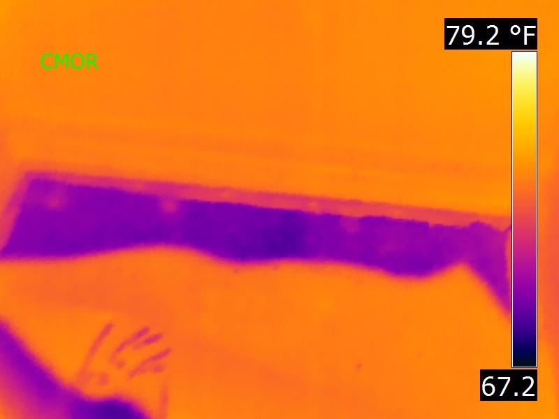

For those that trickle a little water down the drain on a shower stall and call it good makes me laugh all the way to the bank. I had a audience today on a 7 year old home that they (the Realtors 3) could not believe the stall was leaking until one pulled the carpet off the tack board and mopped up the water. I now have another happy client and 3 more Realtors that believe
I did a 4 unit condo building yesterday for an new client, 2 out of 4 pans leaked, not much but they leaked.

I never use more than 2 inches The one in the images I only used 1 inch and they started leaking

Both, As you know Dave I have built a good business that people seek me out for my thermal on shower stalls and electrical panels as my main stay on every inspection that I perform its like second nature. I place a image in the report of the shower stall and the electrical panel even when there is no problem some call it fluff I call it keeping the wolves away:D

I scan every shower pan and bathroom fixture with thermal imaging whether the client pays for it or not. If I don’t find anything, that is affirmative insurance on my part.

I did it again this morning inspection revealed another leaking shower pan that is two in the last 7 days. I am telling you guys want to smoke your competitors do it with IR. It won’t happen by donating $500.00 to the TX relief fund and purchasing the lowest priced camera you can find. Wanta know more call me its free information
