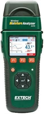

I recently acquired an Extech MO 270. Comes with a 4’ extension handle. No more climbing ladders to reach a high spot.
I got the Extech MO 290 with attachable pin
