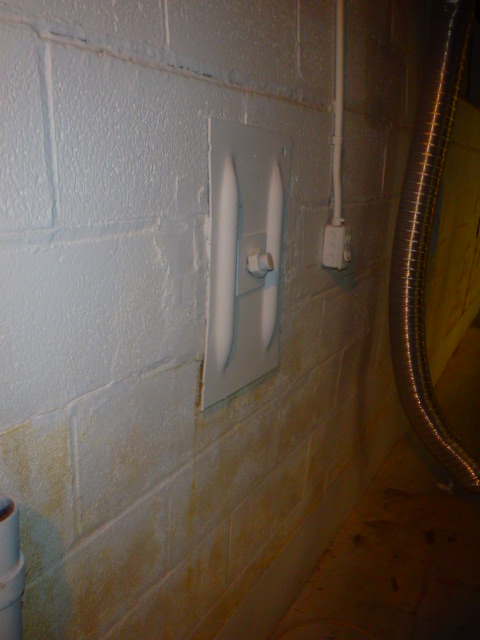

… Q) i only leak/seep (get water in the basement!) on longer, heavier rains.
A’s-- Well, they likely have an exterior crack in basement wall and when the crack is a horizontal crack DOWN LOW (as in photo) then it takes more water, a longer heavier rain to get DOWN there where it then goes THROUGH the exterior horizontal crack and comes out inside the basement, at-along the very bottom of the basement floor/wall
photo…

So that’s SOME of the reasons why ya’s leak on longer, heavier rains, spring thaws.
Q----- Markie Mark, i only leak at–near a corner… why?
A) Most often (not always) the homeowner has an exterior CORNER crack or other exterior opening(s) that allows water to enter, see photo (or last link of several exterior corner cracks)

These are some of the reasons MOST leak/seep at-near a corner, won’t get into all the dang reasons now eh.
Q-- Yoooooooooo Uncle Mark, we only get water in our basement on WIND BLOWN rains, NOT on spring thaws, what’s the deal?
A More often than not, a homeowner will have 1++ openings ABOVE grade, above ground level, that allows water to enter their basement such as poorly installed FIRST floor windows, basement windows, openings around/above, under, basement windows, open-cracked bricks or mortar joints and where a service line enters the house that’s needs caulking and openings around, under, any DOORS, and so on…

Here are a few pics from Friday but do not tell the full story.
Wall Anchors (garbage) - Just use the wrench to fix it:shock:
I have many more for this house and a library of homes like this one some worse, some not as bad.
I get were Mark is going as he has to deal with the **** daily!!
I think we need to do something to educate the consumer before they are ripped off, lets do a Nachi segment and post on are websites!!
Is that your professional opinion or are you just shooting from the hip?
I have seen these used.
Please tell me how you know they have not been effective in dealing with the bowed wall.
Professional opinion.
Does not do much for the horizontal crack at grade level with almost 3 inches of displacement. 2 walls. (Anchors are garbage IMHO in this case)
Water is intruding above the inferior wall panels and at the anchor themselves. No support on the walls above the crack and anchors
Those wall anchors have probably been there for decades.

Mr Larson, a bowed in block, brick wall has EXTERIOR cracks, cracked exterior parging so, how would installing ANY interior basement system and 45 wall anchors repair/waterproof those exterior cracks?
And often, the wall bowed in DUE TO exterior SOIL PRESSURE, lateral soil pressure so, the only means of reducing, relieving-removing some of that pressure acting upon the bowed in wall is to dig, get rid of some of that expansive clay soil as Fairfax link below explains (unbiased eh)

Try reading Mark. I never said this repaired water intrusion.
I was referring to Davis assessment of the wall anchors as “garbage”
They have there there place. Fixing water intrusion is not one of them
