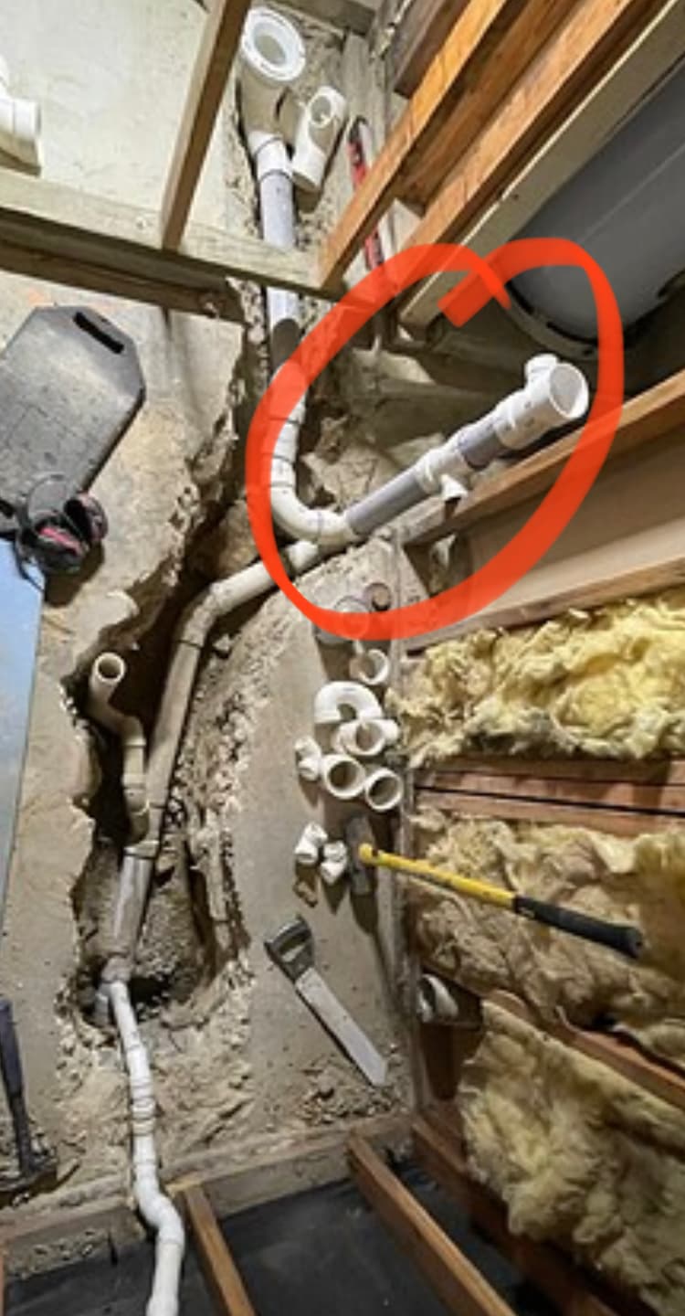

That is some kind of plumbing mess. It truly needs all of it to be torn out and redone correctly. Those pictures were taken at different install stages.
MAKE SURE THE SUB or layman, DOES NOT COVER IT WITH CONCRETE UNTIL IT IS CORRECTED.

It’s pretty hysterical, 90% of you don’t know what your saying or seeing then just like you, a random insult pops up with zero great wisdom on what needs to be corrected, how and why.
Let me guess, you’re not a code inspector, nor a plumber?
Your response is so cheesy, do you really think that someone is about to just cover this up as is? It’s obviously incomplete genius.
You’re also saying that long sweep 90’s can’t be used?

Honestly, again I state I’m not a plumber. However, if it were me I would avoid the 90’s. I would likely dig deeper under that toilet flange, extend the 4" down, use the 4x3 closet on the extension then go straight into the main drain pipe with the appropriate slope. Just my $.02 for what it’s worth.

Avoid the 90’s? I have no idea what you’re saying. This hole is 2’ deep and the toilet runs down a full bubble in less than 5’.
Above the junction is a 2” washer outlet that will pound that junction. Grade all the way to the street.

Well then, fill it in and pour the concrete…forgetting the AHJ.
Derrick, is this a vent?
Yes, but obviously mid stage and incomplete
Why is there a tee in the middle of it? Are you connecting your washer drain here as well? Is this the drain stack for upstairs too?
