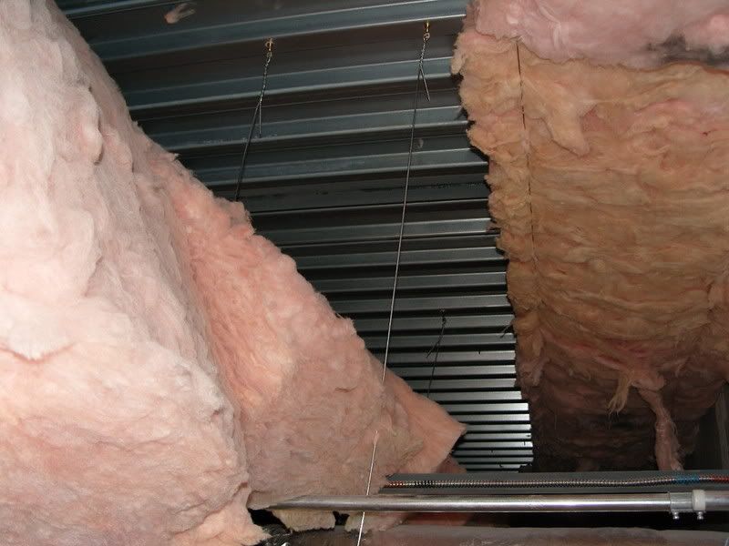

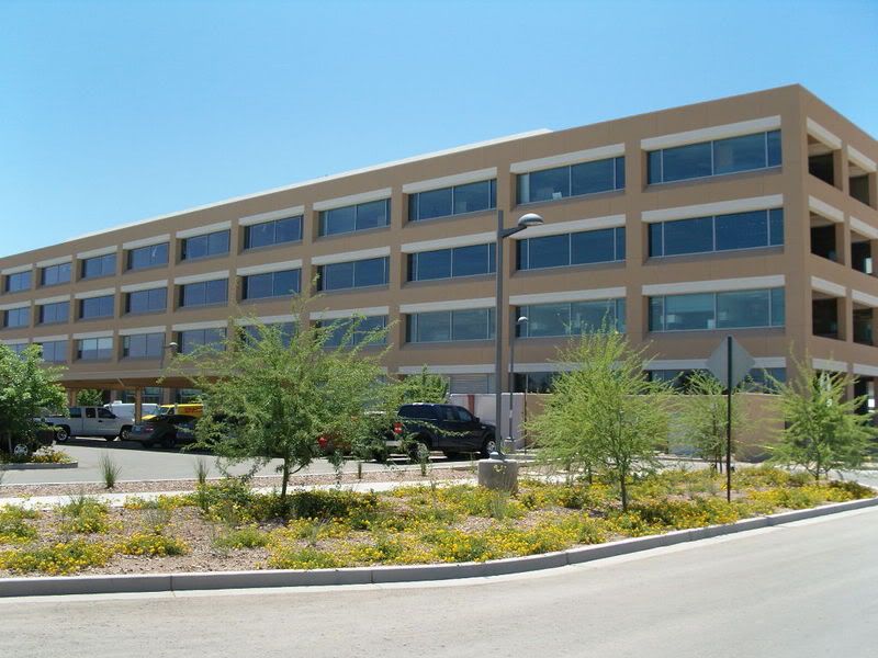

8,000 sq ft portion at the fourth floor of this building today, the only thing wrong was insulation falling from the roof decking…great to have an easy day in the commercial inspection business, start at 10 am, back to the office with the report about finished at noon----:cool:

Dale, that was not a plenum ceiling was it?

Yes it is a big return plenum, but the steel decking is the roof with lightweight concrete and a TPO membrane…so the builder said…I was not paid to inspect the roof, so I did not even look at it—:smiley:
Great thing about commercial inspections, inspect what they want inspected, and nothing more—:smiley:
Must be nice!
The only reason I was asking is because I saw there was no foil or paper facing on the insulation that is not allowed in plenum ceilings.
Although I am not a great fan of exposed batt insulation in plenums due to the material getting infiltrated with dust and contaminates, I guess it is legal.
Did you check for plenum rated cableing such as data, telephone, fire alarm and exposed PVC pipe for roof leaders and such which is not allowed.
Just curious.
Also, why in the world did they not install the insulation on the roof instead of insulation in the conditioned space that will most likely all fall over time?
If the concrete mass would be inside of the conditioned space in lieu of absorbing and containing all that exterior heat, seems would make more sense.
Marcel :slight_smile: :smiley:
Exposed Batt is all we use here, no barrier required on any insulation residential or commercial… -reason-, NO moisture, zilch, nada—:smiley:
Only lighting and fire suppression at the top floor of this building above the drop panel ceiling, everything else is coming from below…actually this builder did a pretty good job. I have been inspecting a different building for about two months now, just inspecting the insulation and wiring at J-Boxes, 30,000 sq ft…over 200 locations they did not install insulation, or it is falling, and they cannot seem to put covers on J-Boxes (tricky::)))–:smiley:
This is the way 95% of all commercial buildings are constructed in the Phoenix-Scottsdale area.
