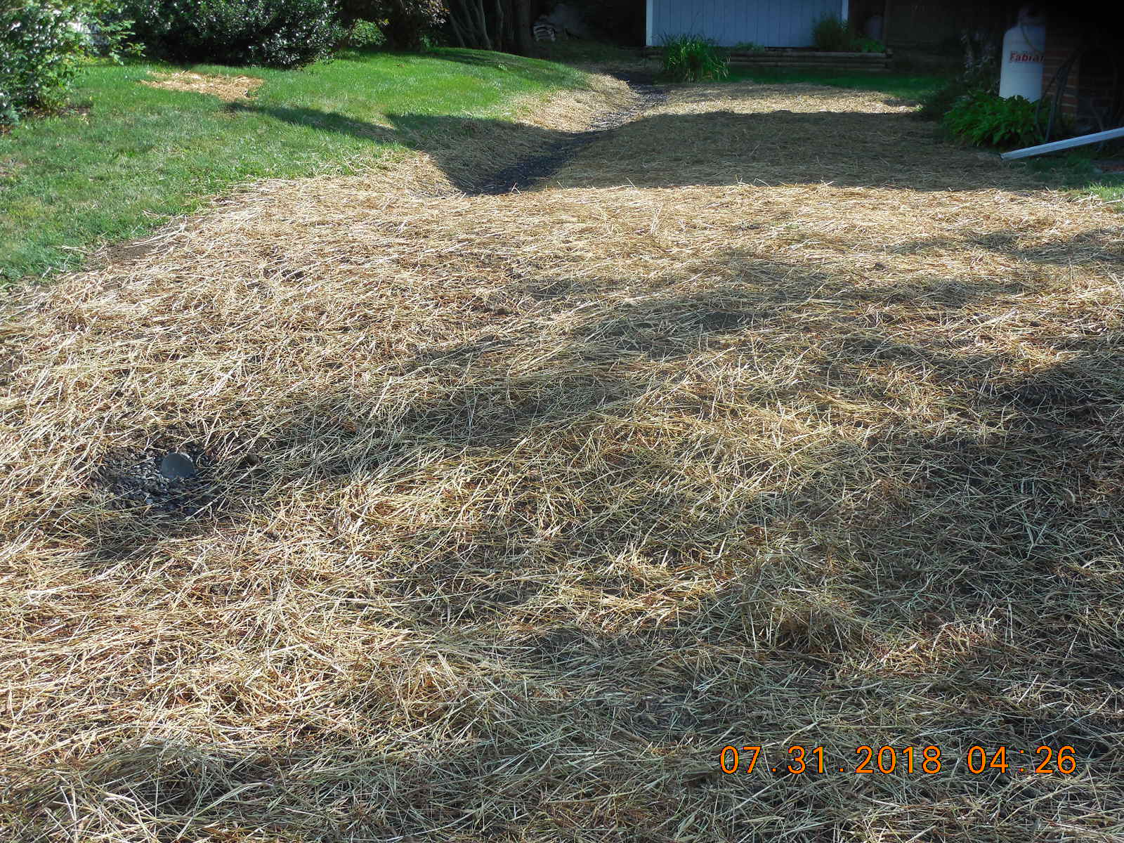

why don’t you try digging several trenches farther away from the stupid house, like start a trench at the :28 mark of video, start THERE lol, dig 'em deeper and horizontally… why? To catch some of the stupid water further away! That should mean LESS water where he dug near the stupid corner.
Yeah man, dig several horizontal trenches, deeper, waaay back there, AWAY from the house, then dig along the house, not just corner. :40 mark, seal the damn gap, crevice too, seal the bottom of the lousy azz wood!
And you could LOWER the dumb azz grade so that some water doesn’t sit-against the bottom of the stupid azz wood.
And his lil BS trench… could dig that deeper and further away as well.

I don’t have water in my basement but did mine a month ago. Pipe to a drainage swale from last year that I installed to take care of all water coming down from my neighbor.
I have to agree with Marcel. I am also not a big fan of using a corrugated pipe. It tends to hold any debris that could come from the gutters or filters in.
I agree Joseph. they do tend to get clogged. I may take a while but Marcel has it down. :smiley:
That down spout connection actually spits out leaves or debris that can come down so it won’t clog the pipe.
That swale is 12" deep with stone and a pipe in the middle.
Solved all my Spring water flooding of my lawn.

I did dig the side trenches by hand though, from the downspouts to the stone trench.
It only took me 2 days. LOL
but you could have opted for an INT drainage system lol
Yup, they probably would have tried to convince me that’s what I needed huh! And I don’t have a drop of water in my basement and no sump pump.
I did this for preventive measures. I am on a clay site, and I do have perimeter clay tile drains that have been working since '66. Knock on wood. :grinning:
