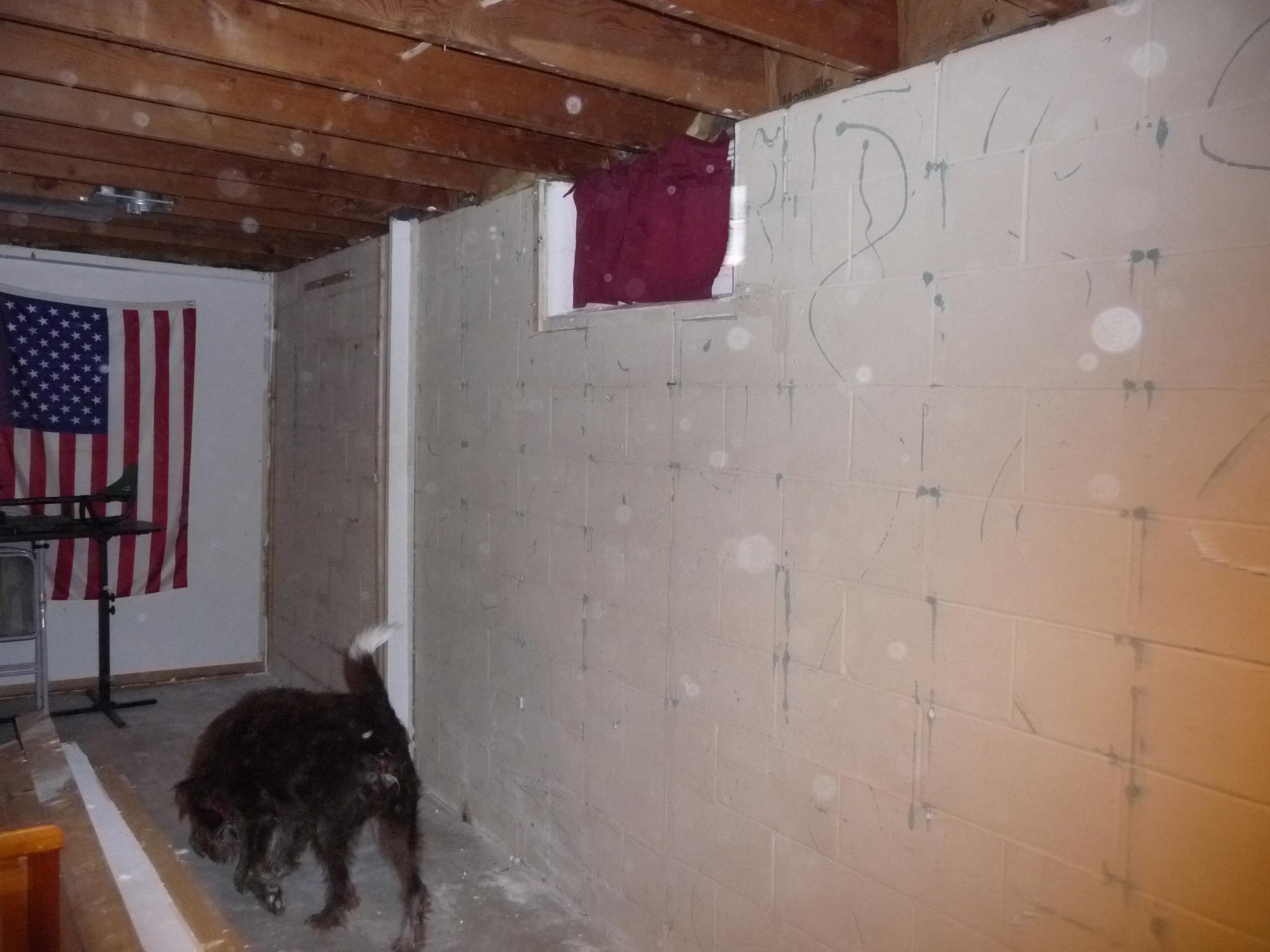

Just did a 203K loan construction write up last week for a home with bowed walls and basement seepage. Cost to contain but NOT FIX the problem was almost $18,000.00
I was a contractor and construction worker for 40 years, I came from a family of masons and when I was starting out did plenty of labor work on foundations which back then were mostly block. Although I went on to be a carpenter my family had me install footing drains and on some foundations I filled the block with a mix of cement and pea gravel. We always waterproofed as best we could with an applied asphalt type coating and the perhaps most important the correct backfill mixture. I don’t know how well they performed but soon after I went to work for a production builder and we did not do drain pipe but we did a coating, backfill was whatever was left over from the excavation as well as broken block, scrap lumber and empty beer cans.
Back to the story; my client is having I beams installed to keep the walls from blowing in further. no exterior excavation. I could do that with a helper in a few days. $18,000.00 ? Nice payday after paying a couple of guys $20.00 an hour for a few days of work. This is for 2 walls. Maybe a half dozen I beams set into the slab at the bottom and anchored to the floor joists on top. This did not include a sump system either, that would be an extra.

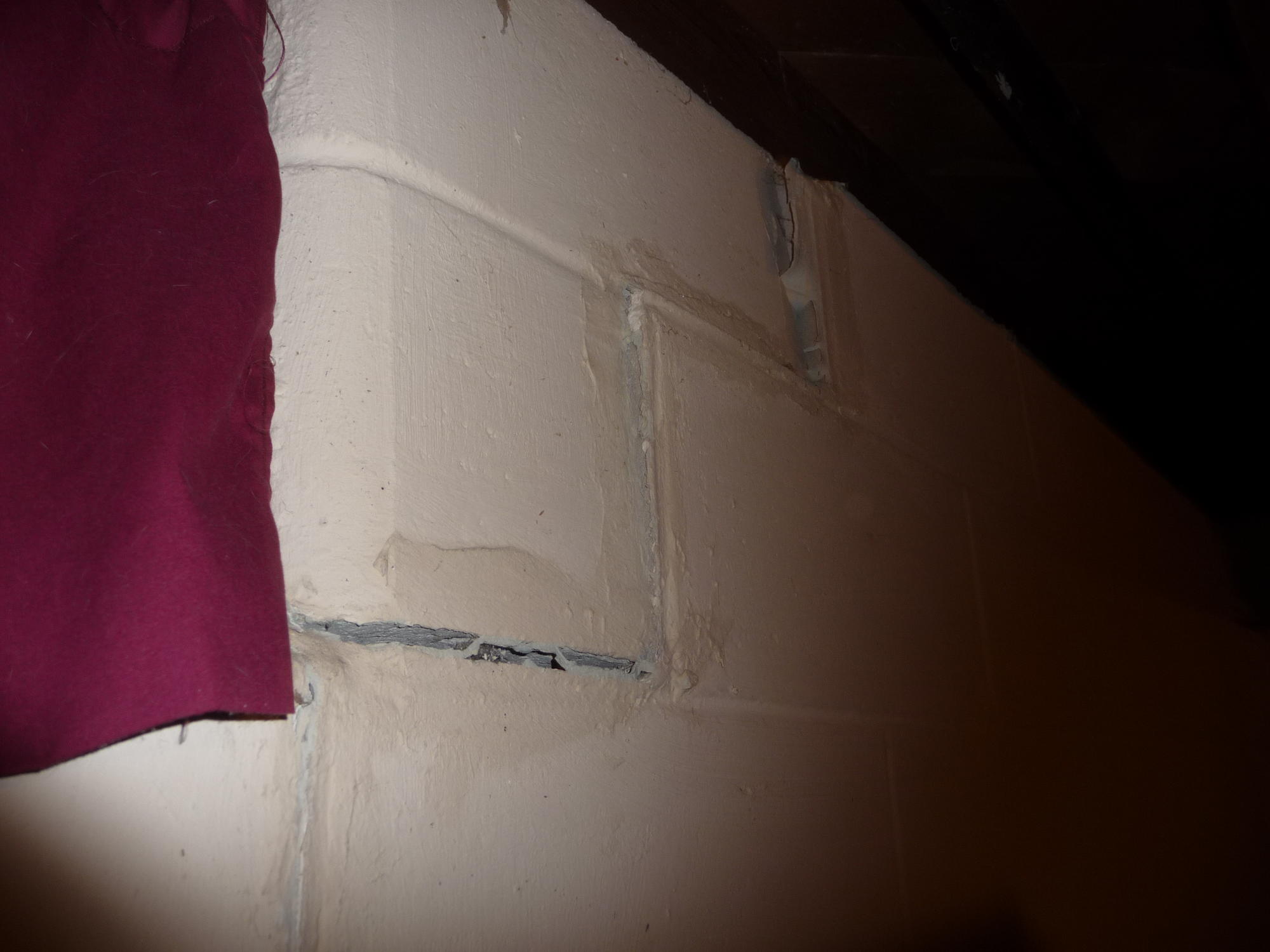

Have seen contractors install beams etc inside against bowed in block walls and the blocks BETWEEN the beams pushed in more, also seen some blocks disintegrate/deteriorate/crumble when they were not waterproofed on the exterior.
Inside view of same wall, they slapped some mortar on wall in several places including on–along the bottom of wall because some of the blocks deteriorated/disintegrated. So slapping that on doesn’t do diddley although it can make the bottom blocks, and pushed-in part of the wall, appear more flush eh lol https://www.youtube.com/watch?v=_3c_JOcFT6g)
I do construction loan write ups, I do not give expert opinions. Having said that I see things I think are criminal but take my job. The contractor is at best stabilizing the bow from getting worse Here’s a picture from the same job.
There is a beam from the first attempt so many years ago, didn’t work then, won’t work now. They are simply putting in more steel, for about the same money you could dig it out and lay new block. I mentioned that and they said the contractor told them it would cost too much?
