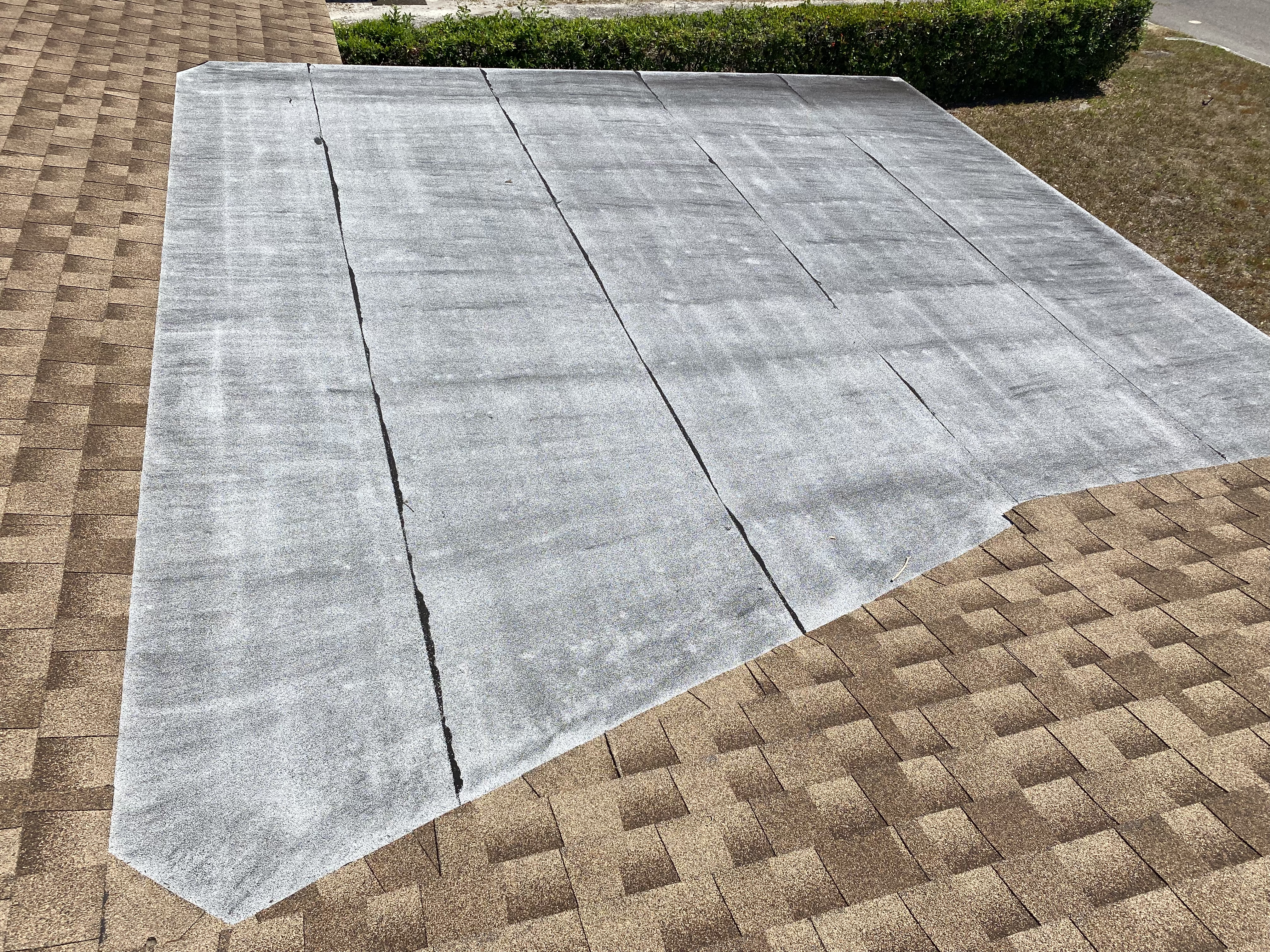

For you that do wind mitigation, I would really appreciate some clarification:
Would you include this in the hip roof calculation? It’s an open porch, however Is this considered “continuously connected to the main roofing system?
Also, On NACHI wind mit training it states “roofs that are metal pan/standing seam or insulated metal panel patio/carport roofing system and not continuously connected to the main roofing system shout NOT be reported” that I understand, my question is, does the same apply for the four point?
As far as I’m concerned, yes.
That front porch is a flat rolled membrane to be counted.
Oh crap there goes the hip credit.
I report all roofs on a 4 point.
The UW is going to see it and want photos of it anyway.
This is what I have always done on the four point as well but I figured if that’s all they asked for in the wind mit that it might be the same for the four point. The other thing is those metal pan roofs for carports/patios never have permits so really you’re guessing the age most of the time.
