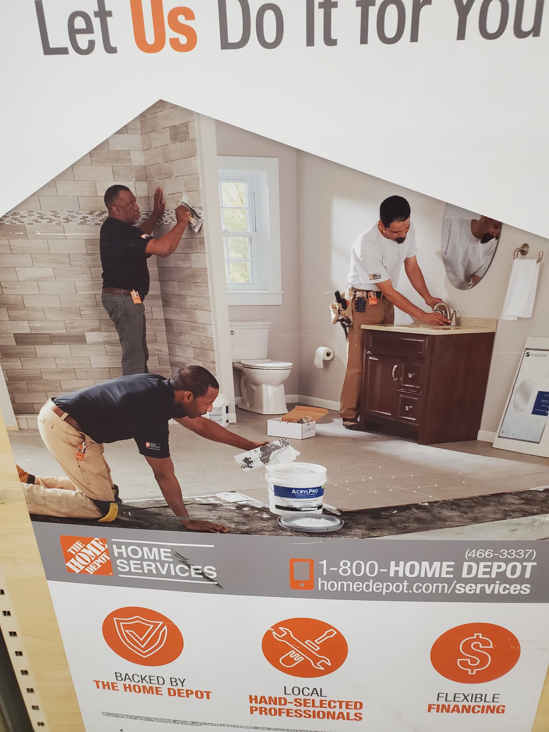

Got a kick out of this ad at home depot. After installing tile for 20 years, I see several things wrong with the floor tile installation… and theyAre supposed to be professionals?
Any takers?
Can you elaborate on what you are seeing wrong?
Just curious.
Sure. Was hoping someone would take a crack at it, but it is kind of hard to see the details.
First of all, he is using mastic, which is made for wall tile. It never lasts on floor tile, especially larger ones.
Second, it looks like tar paper rolled out under the tile. This is not an acceptable tile underlayment, or a crack/isolation mat. And even if it was, its not even glued down to the concrete, it’s just laying over the concrete. So its basically a floating tile floor that is only glued to tar paper. :laughing:
If you click on the photo to enlarge it, you can see the wrinkles in the tar paper
Thanks, I saw the paper, but miss the adhesive, but according to this;
. Ideal for small format
ceramic, mosaic, porcelain and most gauged stone tile on walls or
floors,
The marketing department does not know how to set a proper (detailed) shoot.
Yeah, it says up to 8x8 on floors, those appear to be 12x24.
Professionals never used it on floors, only diy’ers, and it never lasts.
Also, this stuff dries by evaporation, not a chemical reaction like thin set. On top of tar paper it would never cure. It shouldn’t be used on any waterproof walls either such as ditra.
I know, all the professional installers I had on my schools, hospitals, and housing projects never used that on floors either. It was always thin set.
