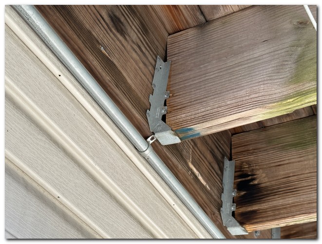

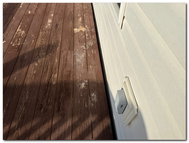

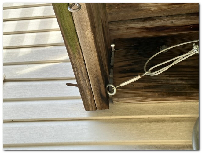

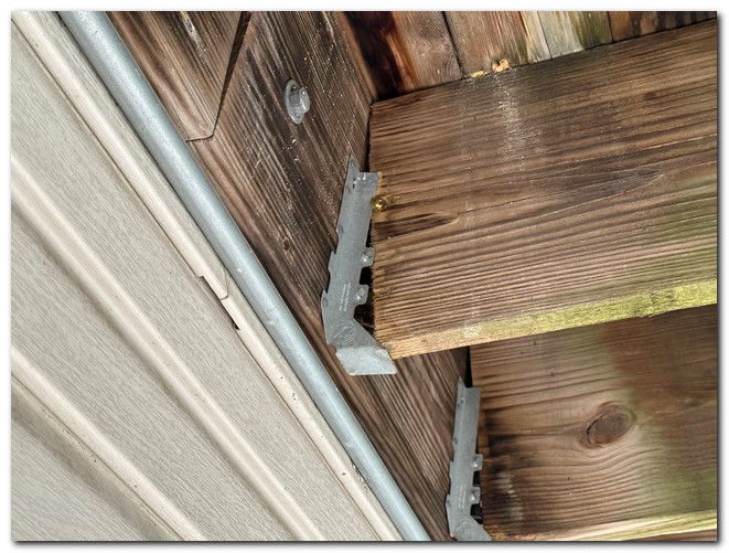

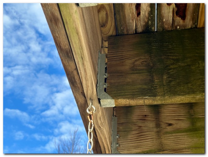

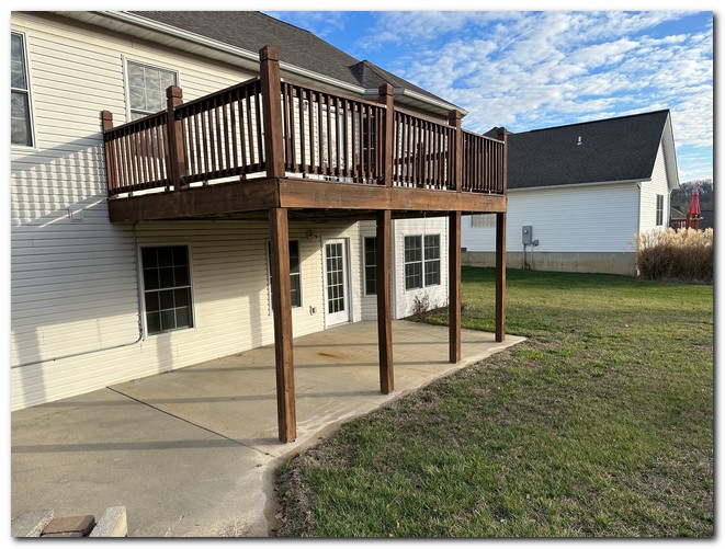

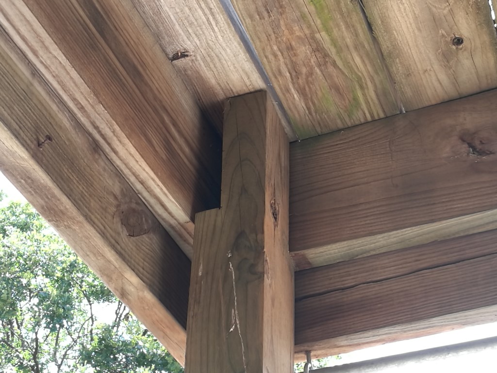

Deck hanging on by a sky hook
In 28 years today’s deck inspection was as close to falling down as any I have inspected. Rotated out at both ends.

That’s awesome. The ledger won’t fail. . . just everything that’s supposed to be attached to it. Did you have you’re yellow / red “condemned” tape to wrap around it?

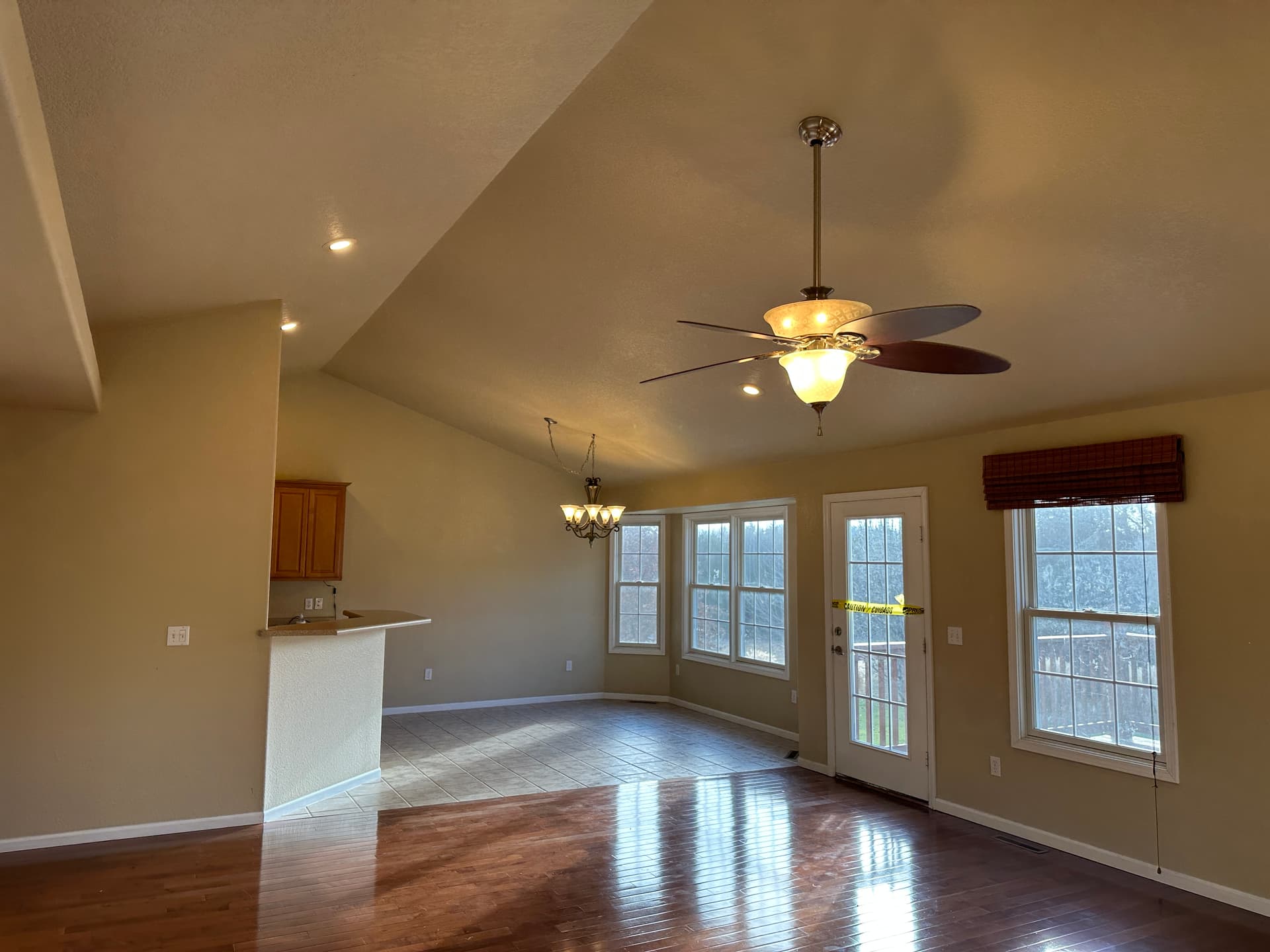

Robert, I carry that tape in my truck and put it on the back door ASAP. The deck is only accessible from the living room.
Fear not, that turn buckle with the open hook should hold it. LOL :rofl:
This is why it’s always best to inspect decks from the underside first, as opposed to doing the “jump test” first.
Do you have a wider shot from the backyard for us?
I had one similar to that 4 or 5 years ago. Not bolted to the home, posts not secured to the ground and frame falling off the notched post. No jump test for me, either!

Appears wind-lift and poor building practices at work.
Someone’s going to get injured from a fall or falling debris.

Can you tell us more about this “wind-lift” damage you see on this deck?
Randy, your deck appears to have been overloaded at some point. Other concerns, one center post bowed. No lateral bracing.
Did you report that as a Deck in need of Replacement…Or recommend that the Firewood stacked too close the home should be moved back to prevent infestation of WDO including Termites?
Tension devices appear to be missing as well. Tension devices are there to keep the joists from being pulled away from the ledger, which might have kept this deck in better shape.
