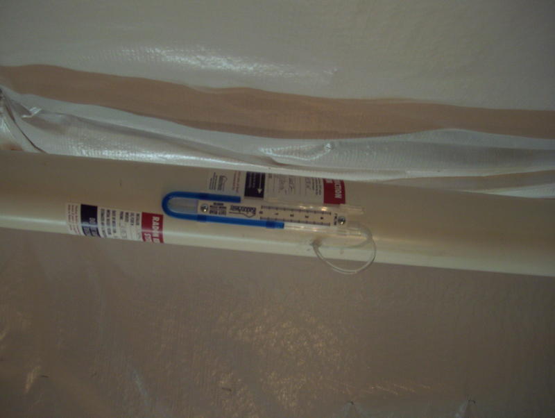

Here’s an interesting question. Can Radon be present within a manufactured home which is resting on a permanent or standard foundation? Ive included a pic of a Radon vent pipe vacuum pressure tube at 1.5" of pressure.
I would say, Yes, particularly if it’s a permanent foundation (without skirting, underground) InterNACHI® - International Association of Certified Home Inspectors
